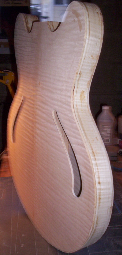

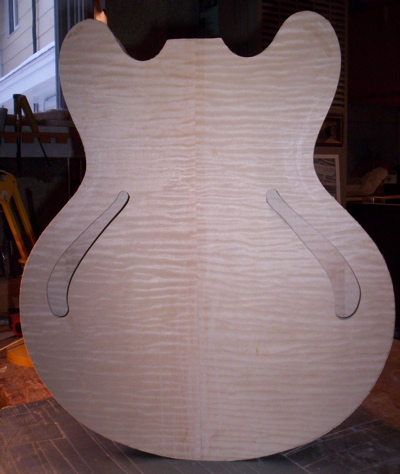

I have not made one of those. I think the "double cutaway" plate would work
depending on the dimensions of that Gibson because it is flat in the upper
bout.
This is what I am making now, A Gibson es335 type thinline. useruploads/KenMcKay/2006-02-28_090822_335_2.JPG">
